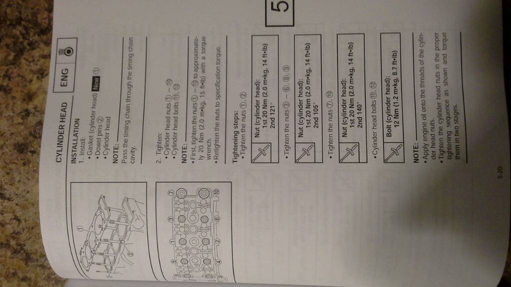

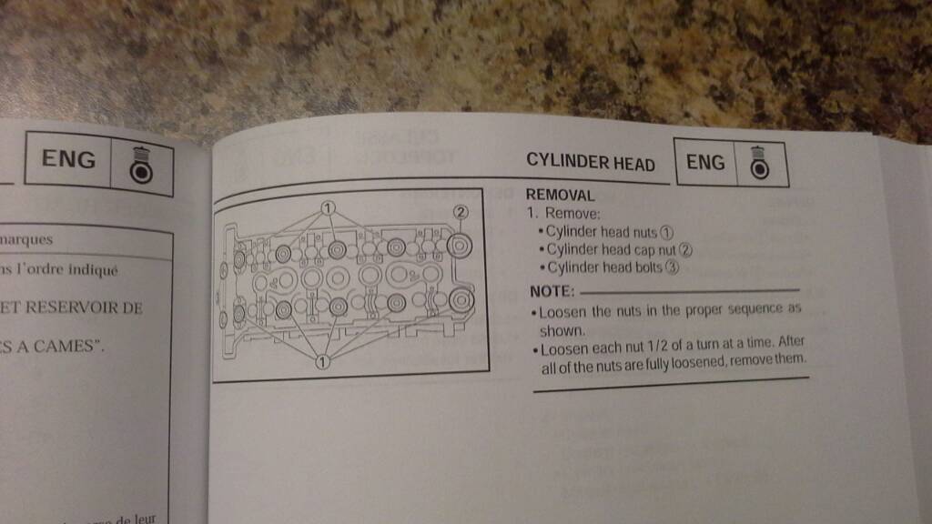

Could some body please post a picture of the Yamaha service manual cylinder head tourquing procedure with stock head studs.
Is there any alternative tourquing specs or method used?.
Should I use new stock head studs if my gasket has been blown?

Hopefully that is what you need
