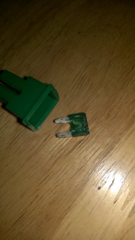

Riding my sled, I noticed the warning light flash a couple times, the sled died and now I have nothing, no power to guages nothing, while I was attempting to figure out what happend the power came back on like it should then dropped out again, did the same thing while we were towing it in, but nothing now again

have you tried swapping the relays around? sounds like you have a bad one or a bad connection somewhere.

yup that is a mod for sure. probably pop'd the oe fuse and could not find one at the time.
