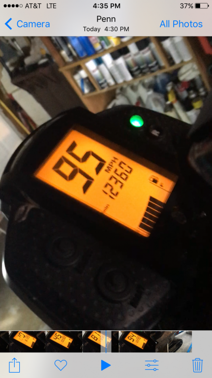

Can't seem to figure out why my 2016 RTX will only go 66mph at 12k rpm. Mods are a few from Schmidt Brothers as well as a 136" 1.5" free ride.
I have Chris' stage 2 clutch kit. Stock gearing (18/41) with 9 tooth drivers. Tested by 2 different riders, talked to Chris multiple times. NEED HELP.
Free revving on a stand the speedo will show over 95mph @ 12,360rpm. riding it'll go 58 - 66.. these are mph on the speedo. I'm in PA 400 ft above see level.

We are trying to help Jayson out. We put in the stock primary spring back in and stock helix on a-1 first, plus took at one shim to get the belt higher since it was setting in a 1/4 inch.
Off the ground does 96 at 12420.
Second time we left the stock primary spring in but change the secondary to b-1.
Still does 96 but lower the rpms to 12370.
Does this sound right?
What to try next?
What to try next?
