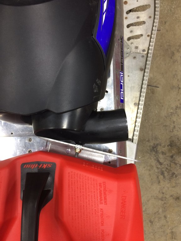

devilnabludress
Full Hindle exhaust. Made the elbow so it is suspended around the actual outlet on the muffler so vibration and cracking won't be an issue.
