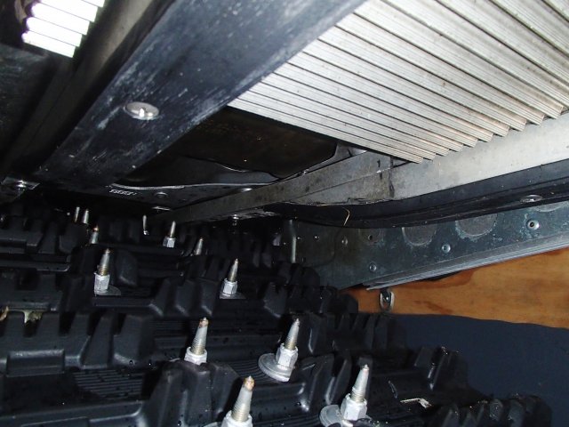

The 08 Vector LTX that I bought had damage to the heat exchanger. Here is my version of the protectors I put on today. I used pressure treated lumber. The sled has 1 1/2" studs (track to tip), so I added 1" protectors. Hopefully this will prevent any more damage.
Mix up some epoxy and fill the large holes. You will rip off every finger on the track that lines up with the protectors.The 08 Vector LTX that I bought had damage to the heat exchanger. Here is my version of the protectors I put on today. I used pressure treated lumber. The sled has 1 1/2" studs (track to tip), so I added 1" protectors. Hopefully this will prevent any more damage.
Thank you for the suggestion. I'll mix some epoxy and saw dust and fill them before I go out.

Did you screw them up? I hope the vibration doesn't loosen them in time. I bolted mine at the back were you can get a lock nut on and one near the front. My protectors taper down in front of the cooler so a bolt was easy to install and when backing up the track has a gradual ramp to follow if needed. Good to taper but not farther then the upper wheels of course. There is some spots in the OEM's that can be used for a forward bolt.

They are screwed in. If I make new ones and extend it pass the bend, I see where I could bolt them in front and in the rear of the exchanger. That's as far forward I could go to drill the whole without dropping the track. Since it's my wife's sled and she usually rides pretty easy, I may just leave them for now and keep an eye on them and then replace them in the Spring.
What hyfax did you use; it looks pretty wide?

I used some wide performance Yamaha OEM's off the Attak. Notice they are installed. I ran a thin flat aluminum strap bought at home depot down the channel on the hyfax were the rail would normally run. So I could have a smooth bottom against the track.
And yes you have to be careful not to go to far ahead to bolt or you'll have to drop the track. Or yet you can loosen the track and take the upper wheels down. They would be easy to put back as well.
