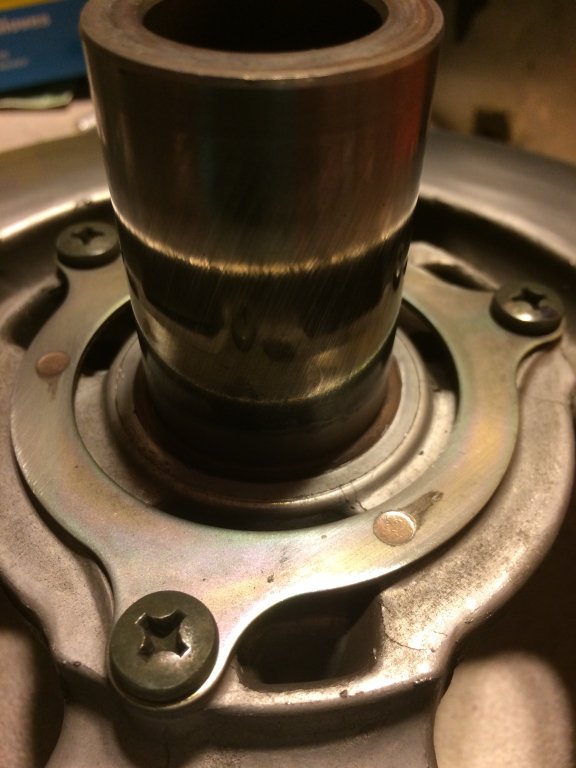

Remove the washers under the three bolts. When the belt starts riding low in the secondary reinstall the washers.

Yes you can turn the plate over, I did mine and OK. Time to replace the bolts.

I measured old and new bolts in this thread:
http://ty4stroke.com/threads/setting-belt-deflection-tip.147366/#post-1357561
