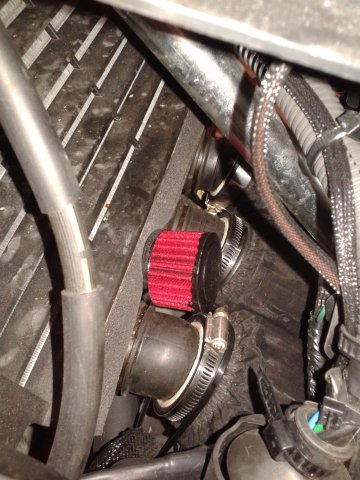

Got a used k&n filterkit

The k&n filter is going of next season. Why....my ridingstyle [emoji12]

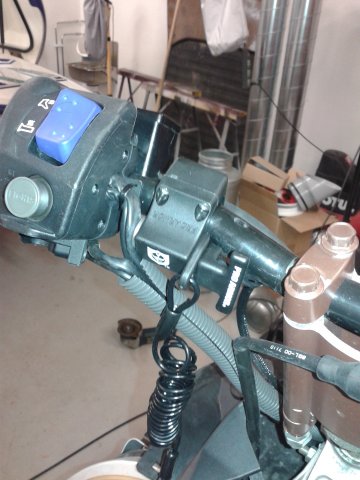

This weekend I started this seasons mods.
The steering is going to be a bit tidy and lighter. Moving to heater switches down. Titanium bars,crmo steering pole and studboy sharper bars
