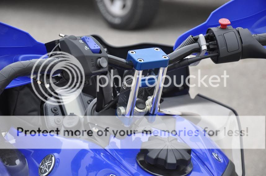

I know the 2013's came with separate thumb and hand warmer controls....so you can go UP or DOWN rather than the silly "to the top to reset back to the bottom".
I wonder what would be involved with this conversion.....My 09 XTX has a "Blank" cover plate over where the switch would be...
Anyone crazy enough like me to even care to do this? I hate having to push the hand warmer button 7 times just to lower the heat 1 bar.....
From this:
To this: (this is a apex but you get the idea)
Im just worried its programmed right into the ECU, so its impossible.
From this:

I put some more thought into this tonight, and after looking at the 2009 wiring diagram for the nytro, there is only 3 wires going to the switch on the left side.
So unless the ecu is already programmed and has 2 extra un-used pins...this idea is dead in the water.
