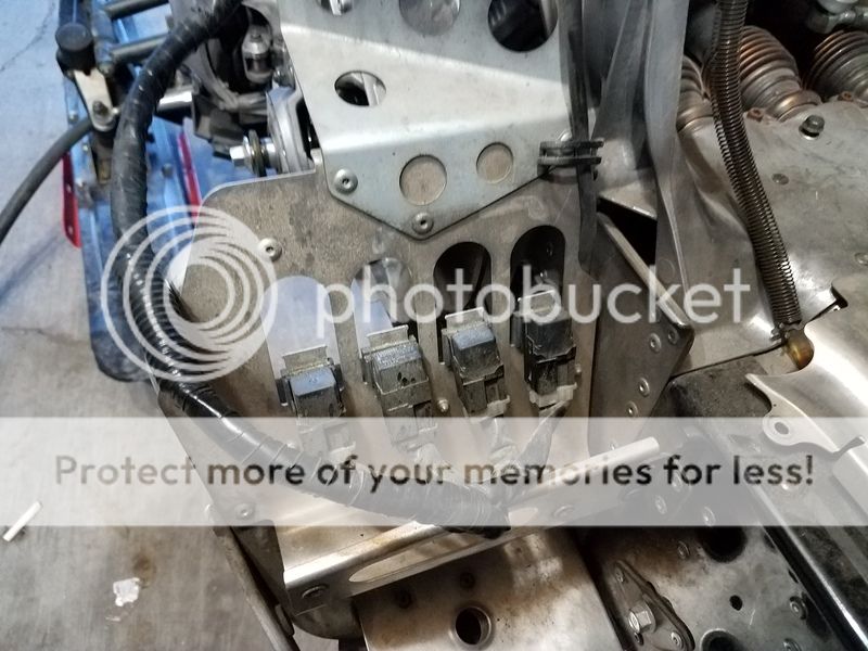

Post more pictures of the wiring and footwells. It appears he left all the wiring in place. If so get rid of that motor and get a apex motor, no fab work and everything will plug right in.

I agree that all the electrical appears to be the stock stuff and not touched.
I'll grab some more pics of that when I'm at the garage again.

Yeah checking if all the relays are in tact. If so. Dump the rx1 motor they are worth almost the same money.

I remember seeing 4 relays on the left I think. I'll confirm soon...

It looks like a apex motor will drop right in for you. That is a good thing, I was worried he had started butchering the harness and trying to wire in the RX1 ECU.

Agreed! I was glad when he had the whole wiring harness for both carb/efi untouched!
I'm working with Travis on getting a motor currently just working out shipping arrangements now
