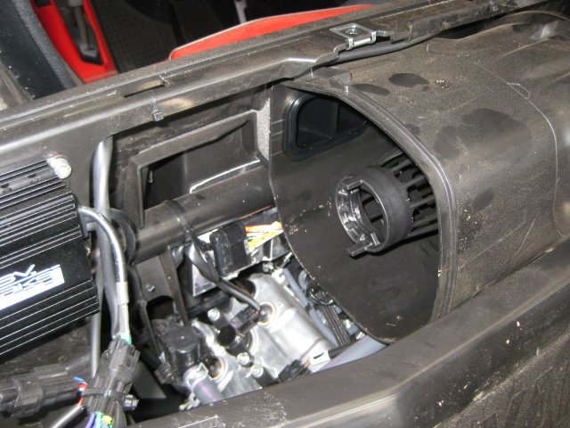

- Remove the Dzus fittings and pull rear filter access.
- Remove Filter lid by turning the handle to "open" position.

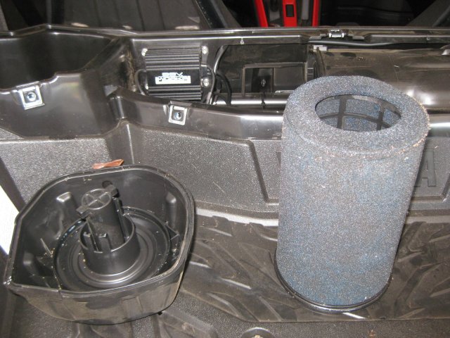

- Remove existing foam air filter.
- Install Pre-Filter over new filter
- Install New Filter into place same as foam filter.
- Hand tighten the handle on the cover to "Close" position, securing the filter into place.
- Re install main cover and Dzus fastener and you are all set.
