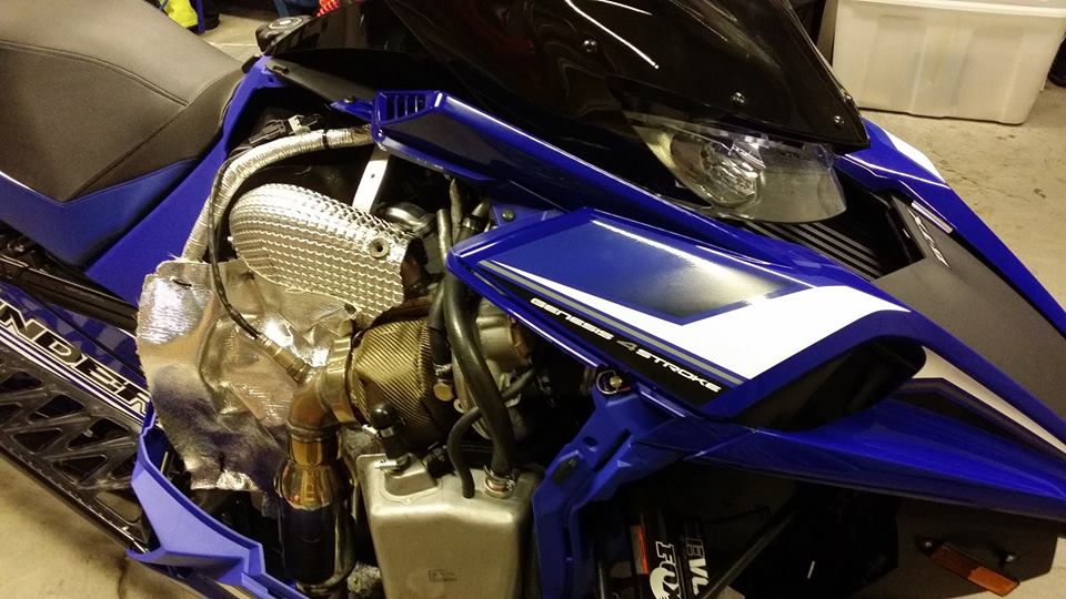

Wow this thing is ripping !!
This turbo kit is made from M&M Racing in Norway (https://www.facebook.com/MM-racing-698447116999977/?fref=ts
Bigger turbo( BorgWarner Efr)
Bigger intercooler
Bigger fuel injectors
Apex oil tank, oil intake in engine is now on level with the oil outlet on oil tank and got rid of the original oil tank Lots easier to change gearing.
All of fuel map and egnigion map+ turbo map is change in the ECU ,rpm limiter is also moved to 9700rpm.
280HP on pump fuel!
This is a sweet made turbo kit from M&M Racing

Run the last mount of the seson last winter with this amount of boost on pump gas and it realy riped.
We fined tuned it now in the dyno and this SideWinder engine i must say is super great and this turbo kitt made from
https://www.facebook.com/MM-racing-698447116999977/?fref=ts is realy loving this engine
