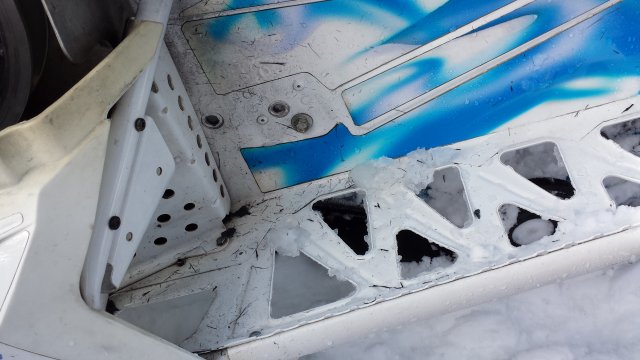

Gates say the belt will never blow and even tho it only delaminated a little bit, it did not blow and if I needed to run the belt to my next destination, I still could have.
Very happy with the Gates belt and now a new one is on. If I had on an 8DN, I would have gone thru 4-5 belts in this time. My clutches are spotless, shiny and work awesome.
Caution tho....if the belt starts to let go, you will see little carbon fiber fragments. Do not grab these with your bare fingers, they go in like a sliver.
