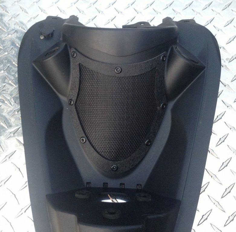

This works great for letting heat escape..

Thanks I saw that vent and am gonna install one and look into frog skin vents for the side panels and drain the old coolant out I upgraded the trail to a 1.50 ripsaw when I bought it had a 1.25 ripsaw with 144 studs I had a few studs come out and one put a good size rip in my track and I am not a big fan out stubsThis works great for letting heat escape..View attachment 127832 I'm not sure on the coolant, I'm sure other members will help you on that...

My sled stock would run 220 ish on the temp gauge with the fun light coming on all the time. I added a mountain tech dash vent, mountain tech mountain cooler, and two mod rod vents behind the front shocks and now run Polaris 50/50 coolant (it was in the shelf). My sled now runs in the 175 range all day and just touches the upper 190's on a really long road run. I have not seen the light in 2 years. Or the fan for that matter. I let the sled idle for a the other weekend just to see if the fan would still kick on.
