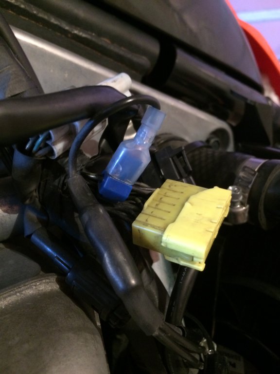

Any idea what the blue clip is for?? It comes of that wiring that goes back to the battery and connects onto a ground wire that goes into the grounding block.

Looks like someone's homemade ground block fix. Are there two wires missing from the yellow grounding block?

Yes two wires are missing. The wire with this blue clip runs back to the battery.

So looks like it's been done. Check that all the wires are good in both and also check the spade connector for the ground wire near the battery. I've had that one give me issues like you described (codes and poor running).
