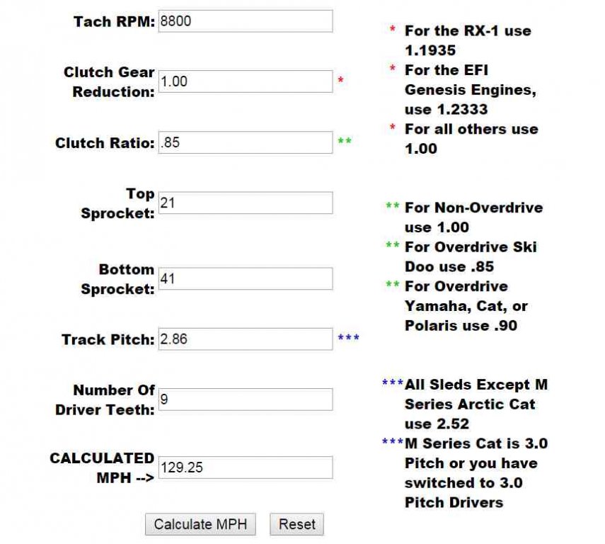

Wow that is interesting....what rpms?I have been up to 129 gps on the stock gears. This on plowed ice. That is really the absolute end of stock gearing. So clutches were shifting completely out. And still original belt. About 650 miles now...and although I don't go beating on it looking to try and blow a belt...I don't take it easy either.
on the calculator I was coming up with 121 or so at .90 OD and 8700....
so for 129 you are around .85 OD and 8800 rpms....nice!
This is good to know for future reference of what gears I will choose.
Did you not see any secondary coil bind or slippage at such an OD? any clutch work or stock?
thanks bud!
Dan

Dan where did you find this calculatorWow that is interesting....what rpms?
thanks bud!
DanView attachment 125547 View attachment 125548
