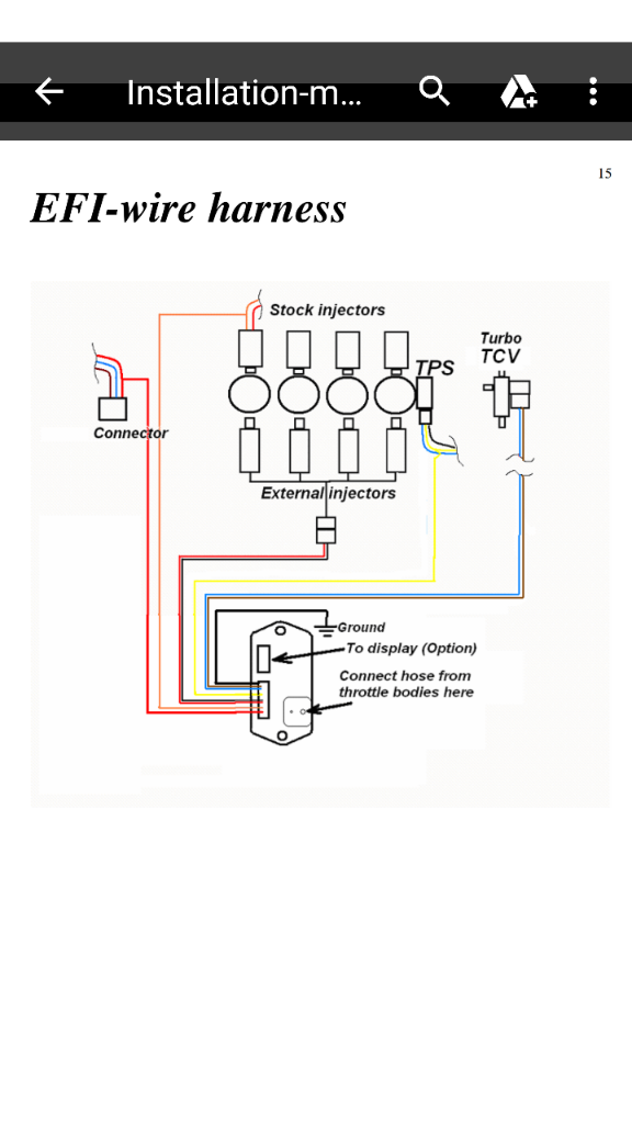

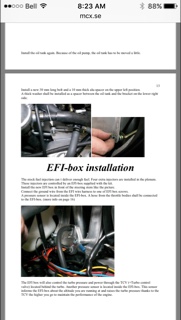

Just about finished installing a used turbo kit from a salvage dealer. This map sensor attached to the efi box is not in the instructions I have. Also can't figure out where this is supposed to mount. The bracket does not fit anywhere in front of the steering column.

it bolts to your steering column, the bracket that is on the back of the efi box does not come with the kit

www.mcx.se you can find the instructions here and it will show u a pic of the box and where to mount it

Thanks, I will make some spacers and mount it there. What about the extra map sensor? The instructions are for a different version of efi box that does not show it.
