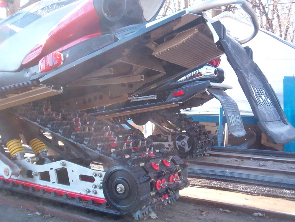

Not with out modifying. I had to run tube spacers to make it work.
Here's what my old RTX looked like with a 144 ext. and a 136" skid.
http://www.ty4stroke.com/download.php?id=27234
the Hartman kit "kicks up". It can be done quite easily though.
Another way, is to saw off the the end tubes and re weld them on in differant angles so the cooler will sit flat against the ext. rather than using tube spacers like I did. The spacer trick was just faster, and worked fine. Never had a stud hit. This is with a Expert though.

Here is another way of installing the 136" Yamaha cooler with a Hartman extension.
