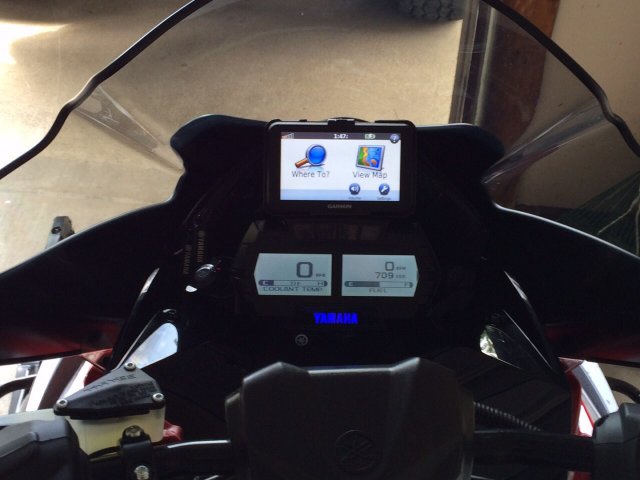

Well I just got this GPS and rigged up this mounting system, so I don't really know how it will hold up. I do know MANY people use the garmin nuvi and everyone loves them and I've not read any complaints or failures. My garmin 60csx worked great for many many years, but I need a bigger screen.

I've had a Nuvi 50 with a RAM Mount on my sled for 3 seasons with no problems. I wired a 12v outlet direct to the battery to plug into so it's always on. Bought a cover that zips over it when I'm parked or weather gets really bad. I take it inside every night after riding.
View attachment 108388 View attachment 108387 View attachment 108386 I think it looks almost factory...lol

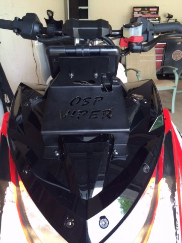

What kind of mount is used with the OSP? Using the OSP allows use of windshield bag I tried it with the guage mount and still useable. I am doing this. Great job!

Thank you!!...when you sit on the sled and turn on the GPS its in a perfect position for viewing while riding...I got the mount for the Nuvi on eBay. I just put a search for garmin navi 50 mount. I think it's a garmin. It's suppose to bolt on to the RAM mount, but I just bolted it to the OSP gauge mount. I had to trim the OSP mount so I could plug in the power cord to the GPS. I think this is the perfect mounting system for a Nuvi on the Viper.

Also the novi is powered by the 12v accessory plug on the dash. I got a low profile power plug (again off eBay for $9). It was described as a power plug that runs the nuvi and charges it at the same time or something like that. I did have to wrap a little electrical tape around it so the plug would stay put. It works great so that's all I care about..lol. Hope this info helps.

YFZ I scored the Ram Garmin holder on EBay for $11 and got a used Nuvi 50 for $20 from a friend who tries driving with his phone. Won the OSP mount at TY Giveaway ride last year so $31 invested! Just have to get the map! I am really going to like this better than leaving it in gogglebag. Thank You! P.s. OSP should consider making a gps mount just like this.
