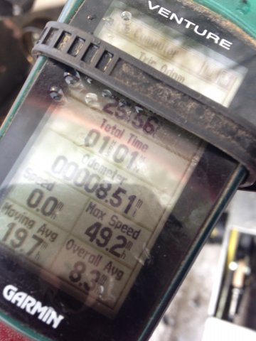

Not going to get any tuning done this weekend but here is a pic from Mondays session
That was a solo run. With us two in the boat it was around 47. That's running 5 psi boost and pulling around 8000 rpms. AFRs were still bouncing from 13.6-15.5. I got a new map from rick at oft to try next time out.
