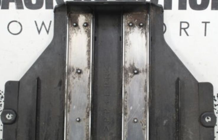

I'm not sure with the older Nytro models but from 2008+, the concern was that the OEM belly protector had aluminum plates down the center where the lips/edges could potentially puncture the longer oil filter. I ran the Napa Gold 1365 oil filter my 08 Nytro which was longer than stock but I also removed these plates and sanded down lips/edges and then riveted them back onto the belly protector.
