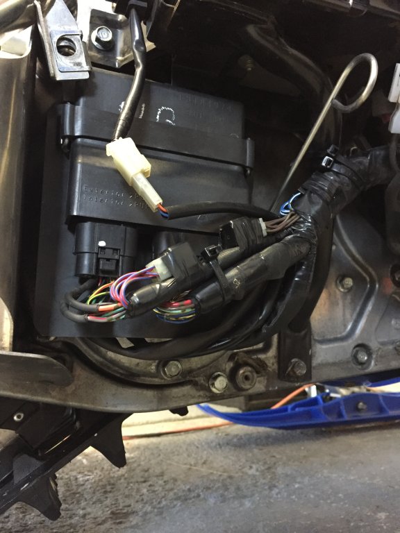

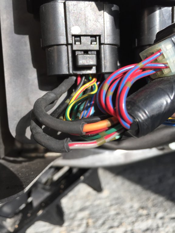

Well, two more times it's crept up on me.
First couple days ago ever so slight misfire I could feel on decel. Till it got stumble. No codes.
Found problem, pin dropped down in ecu plug. Fixed, tested and was ok.
Then yesterday again. Headed out with a PAC. Total misfire with code 34 again.
Tore town right to plugs and everything ohms out great. Has to be break in sub harness somewhere. I'm ordering new one.
(I have two test ecu' and coil to confirm everything)
Best snow in years and only 150kms on dial

Harness finally in. Consensus is harness.
Rechecked everything top to bottom, test rode thinking fixed again and problem creeped up.
It would runs great then ever so slightly creep up on decel. You can kinda feel it, not hear it if that makes sense. Couple more accels, and progressively gets worse where eventually it runs rough and you have to hold gas to keep running. NOTE: I only saw code 34 pop up for a split second then went away. By time limped home it was a full blown code.
Harness showed up yesterday, goes in today.
(Was back ordered hence the long delay)
How much for harness? Sounds just like mine. Doesn't do it till well into a long ride. Tried Ecu connections this time but have feeling it's not solution. Harness is next for sure. ThanksHarness finally in. Consensus is harness.
Well mine made 300 or so mi last weekend with no issues so hoping the ECU connection Zip Tie,cleaning and prodding ATV Pro came up with has fixed issue. Hope so or I will get a harness too. My daughter and I thank you for a absolutely trouble free ride AtvPro.

Been awhile since I’ve been on. Life got busy.
Just to update this code 34
Yamaha sent the entire wiring harness after problem crept up again. Was installed and hasn’t been a problem since. Currently at 12,000kms and she’s running strong. I never did find out where the break in wire was unfortunately. I’ll tell ya what a process trouble shooting this issue. My main sign should have been the different results for every time I had ohmed pins at Ecu.
Anyways I’ll make a habit of getting back onto site much more often. Lots done to her now.
Good to hear from you. I believe mine turned out to be the coil. Havent had a issue since replacing.Been awhile since I’ve been on. Life got busy.
