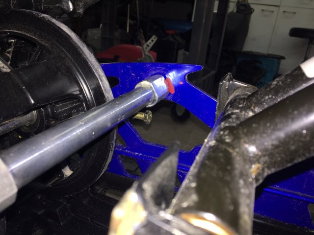

I wasn't happy with the transfer (or lack of) on my 137 skid, so the blocks are out for now.
1/2 inch socket on the impact and the bolts are out. Remove shaft and then remove blocks from shaft. Re-install shaft (w/ blue loctite) with bolts not quite tight, compress the skid to index the flat section of the shaft. I marked the flat with a paint pen and then tightened the two bolts again. It isn't that important that the flats are perfectly aligned to where the rear scissor will contact them; the first full compression of the rear end will take care of that. This just makes sure they are reasonably close...

Thanks! Do we have results, if any, from this mod yet.

I just did this 10 minutes ago. Others will have to answer until I can get out for a ride tomorrow night.

Yep it works but still needs more.

Won't taking the blocks off cause wear on the metal stops on the bar over time?

Seriously - maybe a bit, but nothing I'm worried about. That shaft is probably less than $50 if it ever gets worn/I want blocks back in.

I took my blocks off and cut off two chunks of some underground nylon conduit and stretched them onto the rod. I didn't want metal to metal contact.

can you post a pic of your solution to metal on metal ?I took my blocks off and cut off two chunks of some underground nylon conduit and stretched them onto the rod. I didn't want metal to metal contact.

I took blocks and rod out and drove it 20 miles today on hardpacked very good transfer now when seated it pulls the skis a foot off the ground then lowered to about 6-8" until I let off

you like that eh! I told you youd get transfer like that...now if you over transfer you can dial up the shocks compression and the limiter straps one hole....not a great trail setup ...but she'll love the straights

I don't have a pic right now. The conduit wall is about the thickness of heater hose but a little smaller in diameter. Heater hose was too large. This stuff was so tight I had to heat it up to slip it on.can you post a pic of your solution to metal on metal ?
