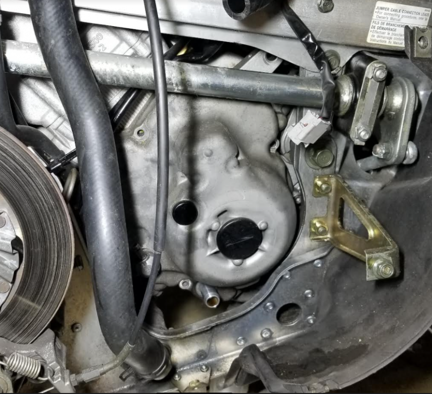

I have an 06 Venture that I am in the process of changing the Stator. --here is the link I posted tonight looking for any help at all--thanks : https://ty4stroke.com/threads/how-get-stator-out-of-06-rs-venture.164564/ I am stuck at the point I need to get the Stator out and the spot is not large enough?
