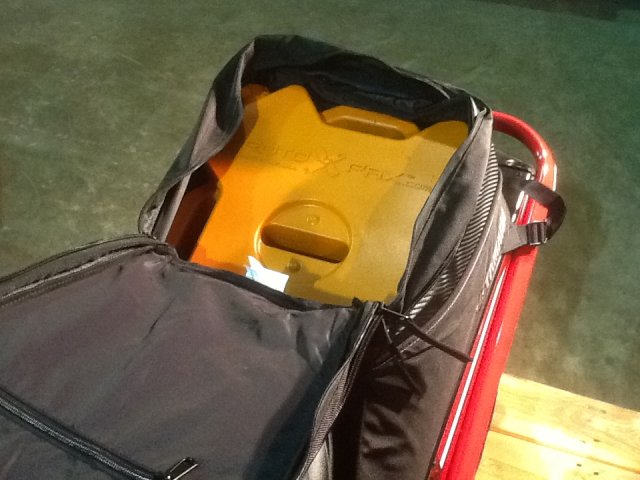

That's a great idea,i wonder if with the 2 gal roto I would still have room in there for my qt. of torco and belt,and few tools?View attachment 122820 View attachment 122818 View attachment 122819 I just installed the sidewinder expandable tunnel bag, (which instructions clearly state it's a Viper bag, btw) and I can easily fit a Roto-pak 1 gallon gas can, with a lot of room to spare. I tried the roto 2 gallon can, and it fit.....although the cap is a tight fit. Perhaps not as glamorous as the Linq stuff, or powder keg....it's sure a lot less bulky and odd looking. But that's just my personal preference.
Hopefully, my pictures are not too grainy. It's an old iPad!
I'm not exactly sure what the foam insert really does....it doesn't fit exactly right. I'm guessing for the back end?
Notice the foam base, and straps inside.
Hopefully this helps someone like myself, who isn't familiar with Viper gear.

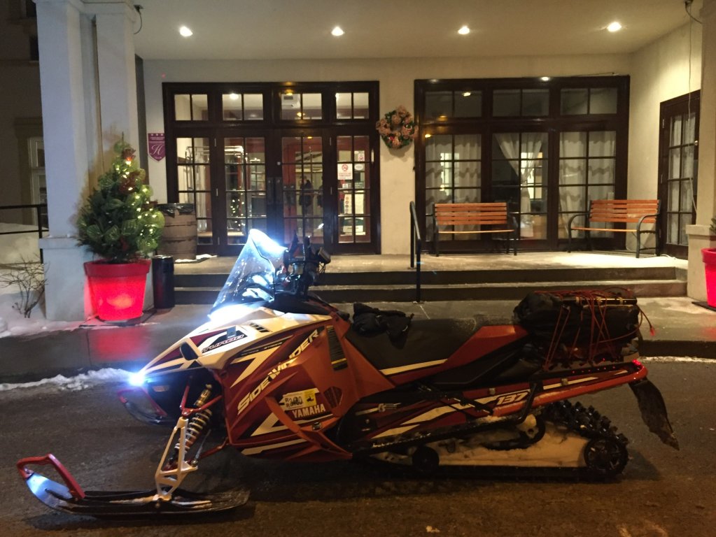

I really like what you did! Couple questions, how does it mount exactly? Also, what do you mean about the rear light, you moved it? Any recent pics?Mechanical install is very straight forward. I had to create wire harness for lighting, mount lighting etc, plus I had to cut it since I wanted to keep the factory tool bag and touch up the finish.
Now to figure out first trip to ride.
Cheers
actionjack
- Apr 9, 2005
- 2,510
- Westminster, Maryland
- www.inspectorjack.com
- 2017 SideWinder LTX-LE
Multi day packed
Day ride pack
The Pro Series rack bolts down to the top of the tunnel with 6 bolts. Since I cut off a portion of the rack to retain the factory storage bag I only bolted with only 4. The light harness only refers to my personal LED augmentation of the running taillight and brake light. This setup served me very well with only the shock cord tie down being a bit of a hassle (compared to say LinQ latches). Once tied up nothing moves and it allows for tying down almost anything particularly backpacks.

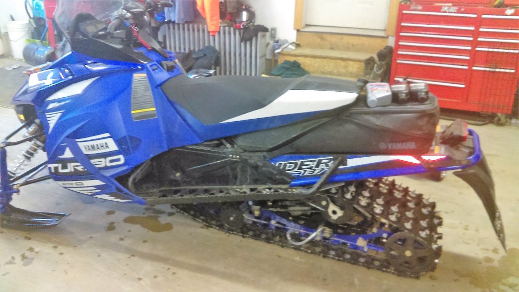

This is a sidewinder listed exspandable bag,much like the one up top who has a roto pax loaded into it,now I like that idea. Mine is sma-8ly63-00-bk and works good,but the funky steel plate that this cat chassie has to mount the seat to,well cover that spring type plate with tape,or it will wear into bag.
Ive got the same bag..IDEA...get some of the black adhesive door edge guard and cut and apply to that metal tab!
I need another set of straps with the hooks for that bag...anyone know where I can score?
