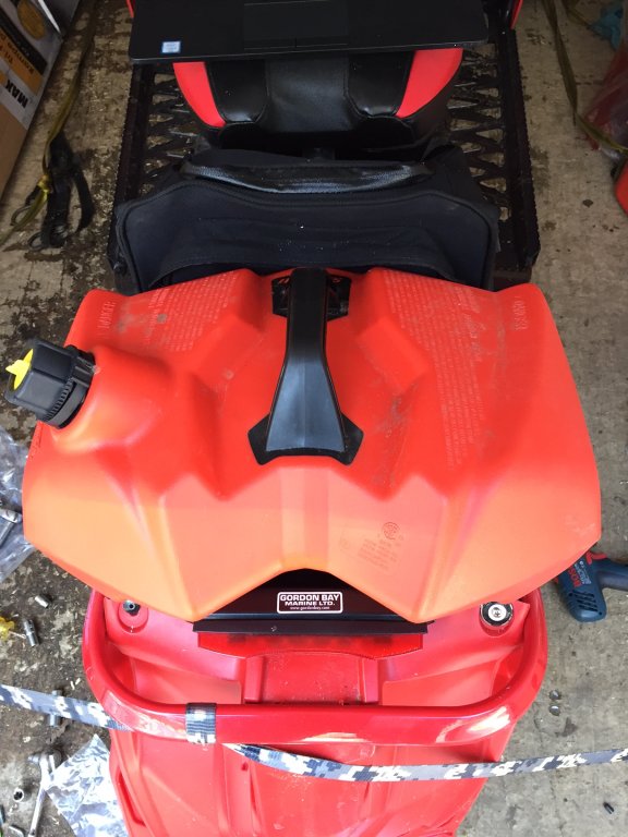

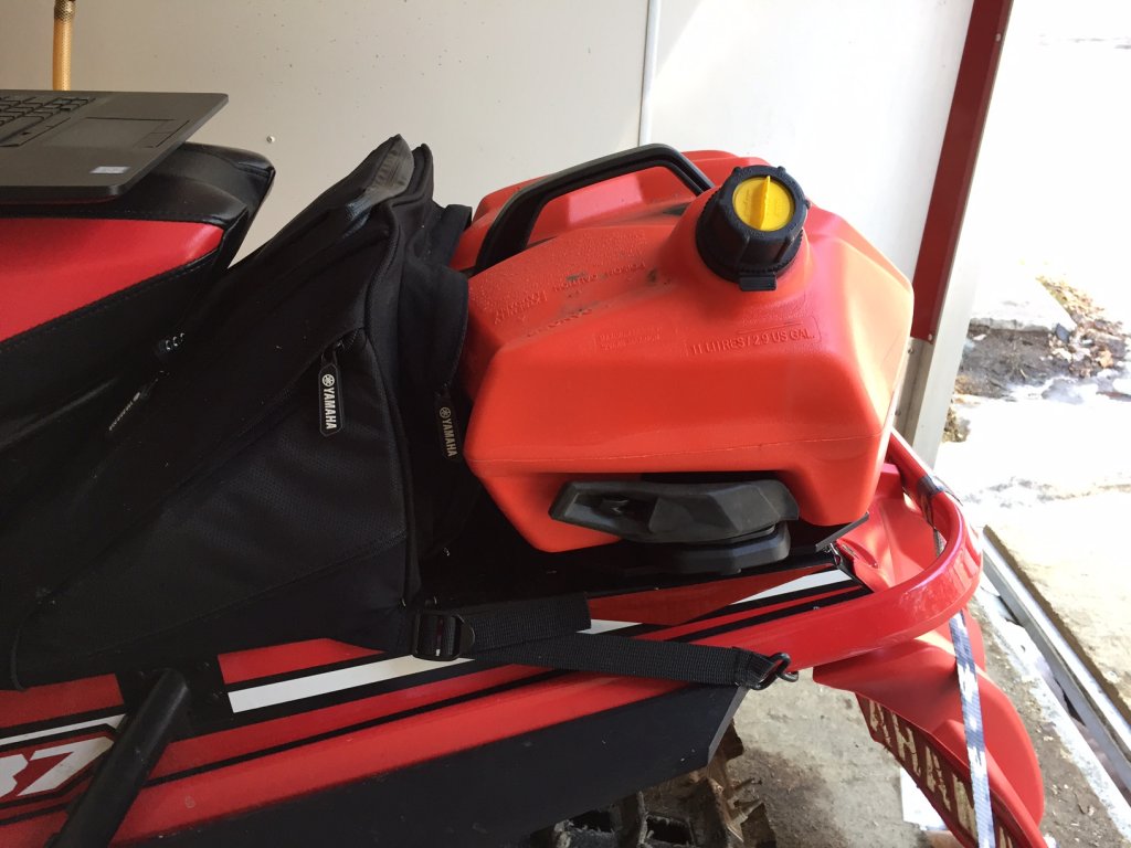

I have posted pics of both set ups , that I have used .Still weeding through the potential purchases this fall ....Like the quick detach feature of LinQ. For you guys that have the Whiteout Technologies or Up North LMP1 (Seems like both require a little drilling to mount), are any advantages to either bracket over the other?
I used the universal Up north attachment on the Cat snocross , as it fit better than the LMP1 original.
On my 137 LTX LE , I preferred the Whiteout 2 piece attachment , as it allowed me to get the brackets right near the snow flap , to allow room for the bigger tunnel bag that I am using , instead of the tunnel pouch that was stock.

yep thats what I ran on my 16 zr9...with medium linq bag.. I posted the install on HCS and others have used it since..I recommend it..

The spacers that I used for the White out linq attachment , were actually sent from Up North , and it raised the Linq gas can up enough to clear the rear light .yep thats what I ran on my 16 zr9...with medium linq bag.. I posted the install on HCS and others have used it since..I recommend it..
On the AC race sled I, there wasn't a rear light to clear so I used the Up North universal , with out spacers , and both installs were easy .
