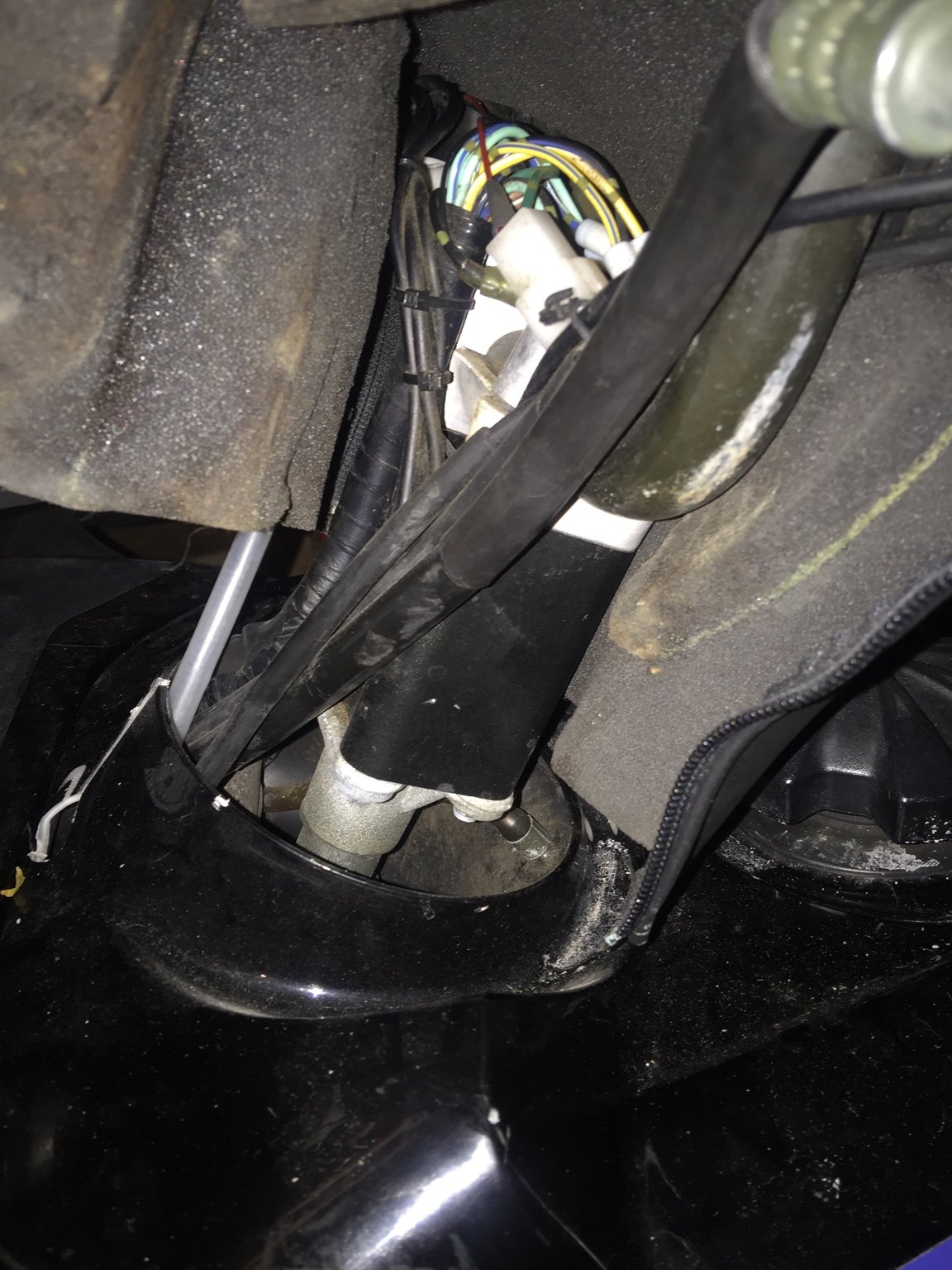

So I took it out around the yard and it moves good and then it seems like the throttle sticks which causes that tors system to kick in. After I flick the throttle a couple times it goes back to normal but turning seems to make it stick more. When it kicks in the rpms are stuck at about 3k. Here is a pic of the handlebar riser
- 7,693
i think you need the 05 rx1 mountain cable as yours looks way too tight. with a 4" riser on my 05 rxwar i had to run the mountain cables and brake line but still had room to go higher .
