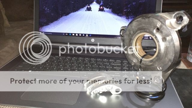

I just picked up a 2011 Apex SE and the owner threw in the Ulmer clutch kit he had on it since new, as he put the factory helix and primary back on to sell, but threw it in as part of the deal..
I put bout 100 miles on it so far, so have a good feel of the sled, Not a great feel, but I know how it rides, engages backshifts etc.
The sled has 9300 miles, and apparently this spare clutch kit from Ulmer does not come with a secondary spring.. So the secondary is 9300 miles old, the Ulmer kit ( Helix/Primary) is about 8500 miles old..

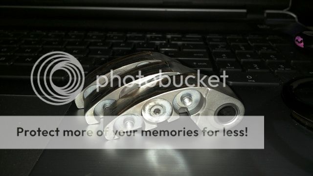

I noticed some notches on the helix, and some wear on the weights. Is this a concern?

Looks normal to me.
Interesting . No weight in the heel.
kviper
After that many miles I would get new springs from Ulmer and your good to go!

Thanks guys. Yea like I said , stock primary and helix is in it now, but since it's here, I'm tempted to swap the kit in to see the difference. I'll order up some new springs then and go from there.

Can't see the other side of weights but they look like they need more weight on them, probly mid 60's and loaded heavy on the base, the marks on helix are from machineing i would assume nothing should hit on back side of angle
