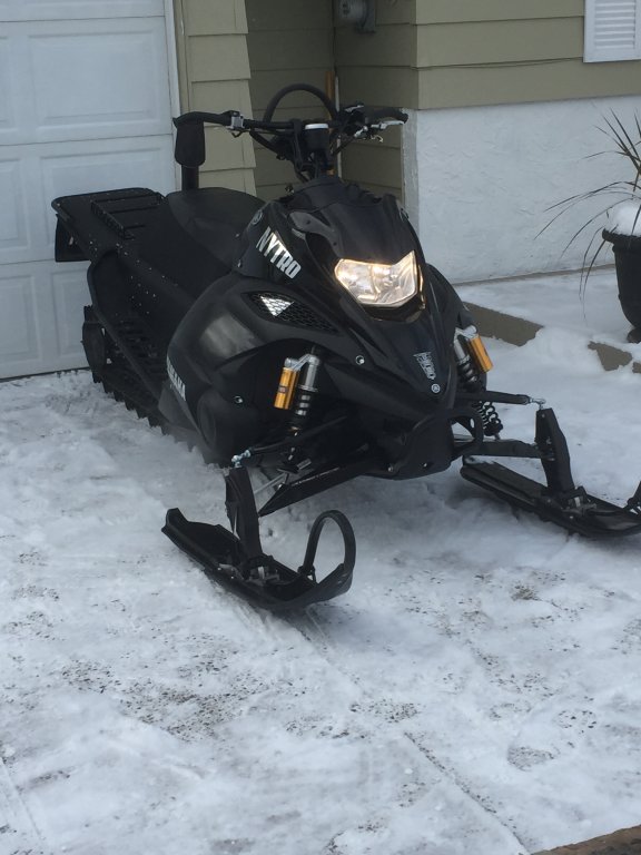

Looking for info on upgrading my 2008 nytro mcx 240 to 270 hp kit
I tried searching forums and mcx for pics on routing/ plumbing etc.
I sent my mcx ecu to Prince George for the 270 remap
I have a spare high pressure external pump from a past 310 mcx apex
Still need a fuel regulater , suggestions?
Sled is a 2008 mcx 240 w 174 3" camo
Timbersled
Zbros front end
Cr tunnel etc etc
Brown injectors
Cr tunnel dump
Any leads to schematic and or pics for install would be very much appreciated!
