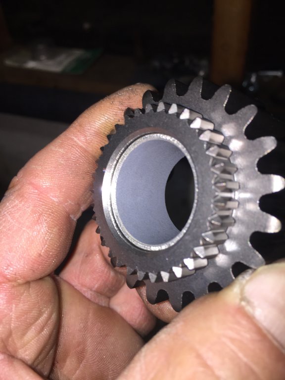

How did your bottom gear look on yours (the 40t)? I'm installing a new top gear but the bottom gear feels really rough feeling around the edge of the teeth, but it almost looks like it was made this way, doesn't seem normal though.
Pstn head
All my other gears seemed fine, even the top gear (the teeth) seemed good, it was the coating on the surface where it contacts on the upper shaft that was worn, pretty much all gone. The first pic is the old gear. Notice the coating missing compared to the new gear.How did your bottom gear look on yours? I'm installing a new top gear but the bottom gear feels really rough feeling around the edge of the teeth, but it almost looks like it was made this way, doesn't seem normal though.

View attachment 129351 View attachment 129352
Ya mines the same way, so I'm changing it out. I was just curious about the bottom gear. It looks fine but when you rub your finger along the outside of the teeth on the face it feels rough and not smooth like the other gears. It's almost looks like casting marks on the gear.

Pstn head
IMO if your not happy with how your bottom gear feels, change it out for peace of mind, probably it's fine but for what it's worth, I would change it out. I also replaced both my chains, the forward drive chain had zero adjustment, if the chain would have stretched anymore than it was already. Also have a look at the plastic guides, especially the forward chain guide, mine had groves in it from the chain.Ya mines the same way, so I'm changing it out. I was just curious about the bottom gear. It looks fine but when you rub your finger along the outside of the teeth on the face it feels rough and not smooth like the other gears. It's almost looks like casting marks on the gear.
Pstn head
It's hard for me to tell from the picture but I don't bielieve it's too expensive and since your there I'd change it out, only for piece of mind.When you look at this picture and look at the top of the teeth you can see the burrs, they should be smooth.
I pretty much replaced all my chaincase internals, since I was in there. IMO these top gears need replacing more often than not depending on how many km's per season.
