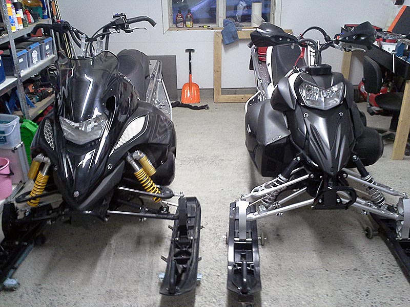

Now my garage looks like this.
I'm still working on the garage itself. I will change the floor later on and do some other stuff. But I like it here to work on my sleds. Even installed a big screen for showing snowmobile movies on while working =)

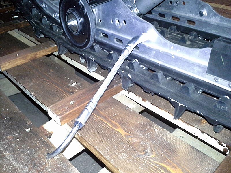

Did some rebuilding to the Phazer today. My wife will have that sled now, so I am making it so stable as it can be. So I moved the idlers wheel in the back out to the original position and added a fourth wheel in the rear. I know, it's three different kinds of wheels in a set of four. As long you keep the speed up, no one will notice =)
