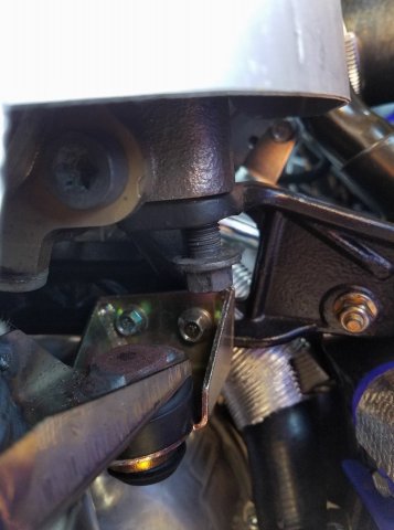

2 guys on the french chat lost their 2 bolt under the turbo! ![Censored #$%&* #$%&*](/styles/default/xenforo/smilies/censored.gif)

Wire them? Nordlocks? Stage8? Can you post a pic of them?

Is this bolt accessible without pulling muffler?
