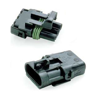

I just got around to installing my starter saver. Super easy install. I ended up using a delco weather pack connector for easy disconnect. My indicator is mounted in the panel that the ignition switch is in.
