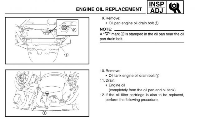

Anyone tell me where the crankcase drain plug is?
comatoast218
Thought it was in the rear near the track.
Its a oil pan bolt by the filter that has a copper washer.
Yannie
Only thing beside my filter is a sensor.
herndonp
Yannie
Found it. Thanks

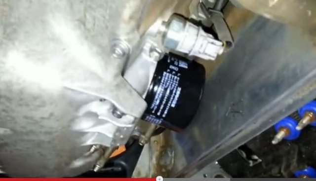

herndonp
Here is another Pic you will see the allen head bolt below the filter to the left. Here is a youtube link https://www.youtube.com/watch?v=_XmF9xGY36M
