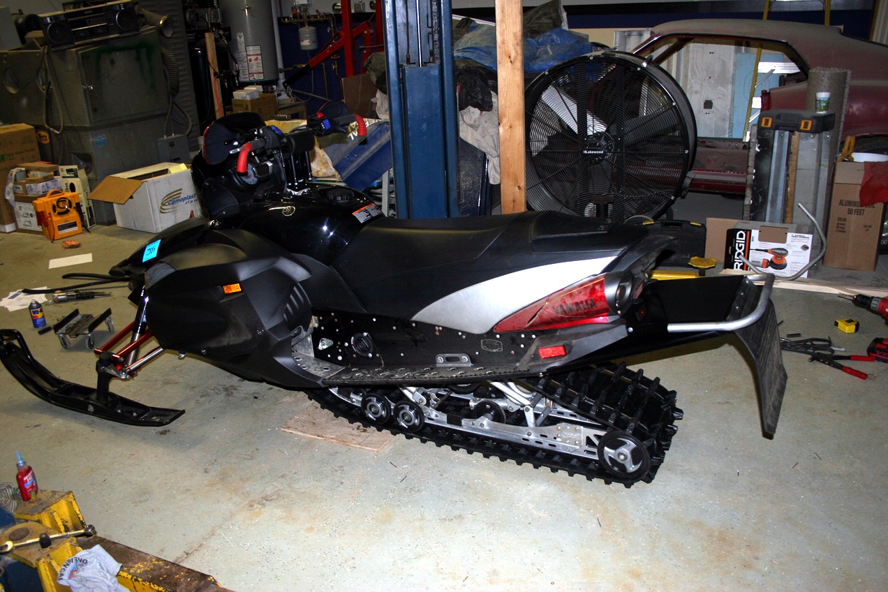

Here are some pics of the TracksUSA extension kit on my apex. Things went pretty good. Its a full day job with all the extras like the tunnel and the plastic mods and stuff.
TracksUSA 136" Ripsaw 1.5"
Hartman Inc. 144" tunnel extension.....had it powdercoated to match

why didn't you just buy an attack?
SharkAttak
nice job, when you had it all apart did you change the gearing to the 23 tooth drive? and did you change you seconadry spring to the white w/ 3-3 twist? i believe that is the attak set-up

SharkAttak said:nice job, when you had it all apart did you change the gearing to the 23 tooth drive? and did you change you seconadry spring to the white w/ 3-3 twist? i believe that is the attak set-up
Not yet. I am going to see how it is as it sits. I did'nt get a chance to ride it yet because of rain taking any snow that was left and my wife planning my sunday for without me knowing!
Do you think it will have an huge effect with the apex clutching?

skoalring11 said:why didn't you just buy an attack?
I wanted the RTX for the Fox Floats and the all black plastics. I also went with an 1.5" track instead of the 1.25 on the attack. This extension set up was also a christmas gift. The only thing i put up was for the hifax and the tunnel extension and some track clips.

looks good, i have the attak and i wish that i had the longer tail piece so i could carry extra gas. may put it on not sure yet
If that is a Crossover 1.5" Track it is going to hook up
like crazy! You may want the extra clutching and gearing
in the white stuff if we get any
especially boondocking.

True Blue said:If that is a Crossover 1.5" Track it is going to hook up
in the white stuff if we get anyespecially boondocking.
TB
If you mean by crossover a cross country then yes it is. Its a Camoplast Ripsaw 1.5. I hope we get some white stuff too! I haven't had a chance to ride it yet with the new set up.

chaserdog said:looks good, i have the attak and i wish that i had the longer tail piece so i could carry extra gas. may put it on not sure yet
www.hartmaninc.com is where the 144" Tunnel extension is from. Comes in aluminum finish. I had it powder coated to match the RTX tunnel.

Great job. I am so glad to see that I amnot the only one that converted their RTX. I love my stretched out sled. I also went with the 144" ext with my 136".
http://www.ty4stroke.com/viewtopic.php?t=32661
