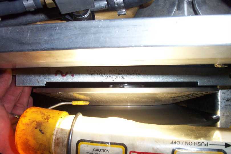

Bought the two washers one looks just like a plain old washer and one has a stepped side dont realy know why or what for? I put them both on and checked my offset with a Kent-moore 15MM offset tool. My secoundary was out way to far pulled one washer from the back. Still out to far had to pull both washers out and put a real thin one on the back to get offset right!! So i dont know how your offset is right??? Or what Yamaha wants you to do? I think i will leave it where it is, the plain old thin washer should be just fine.

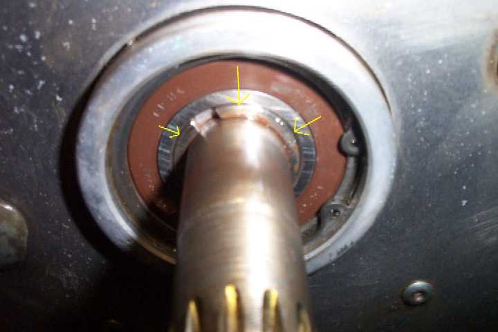

That washer with the stepped side goes with that side right against the new locking collar. If everything on the chaincase side is assembled correctly, it will allow the correct amount of jackshaft length to remain on the secondary side. Once you put the collar on and tighten the new locknut, slipping the stepped washer on will make for a perfect fit within that new threaded collar. I simply followed the order shown on the '04 parts microfiche by placing the washers as shown in that specific order on the sled. If you notice, the washers between the secondary and the jackshaft bearing aren't optional. Only the shimming washers between the secondary and the retaining bolt to hold the secondary allow to use optional sizes for proper shimming.
Some one might correct me here, but with this new set up (from '04 on, and with the stock clutching) you will probably use the washers as indicated in the parts catalog.
Also, if you've noticed, on the '03 RX1, it does allow you to use different thickness washers between the secondary and jackshaft bearing. My assumption here is that the new threaded collar changed the distance and that it's required to use the two noted washers.

Yea it is funny. I have the same washer on the back side of the secoundary as i did with the 03 set up. The new collar does not stick out any more than the old set up. I know it is all assembled right.?? The washer with the stepped side goes up to the new locking collar, but it rides on the inner bearing race so there is no way to move the bearing back any? And the jack shaft is the same depth that it was before i took it apart. (i marked it) And that is why i have to use the same shims.. MMMMM i wounder??

Here is a pic you can see the new collar is flush with the bearing. Just like the 03 set up was, wonder why they did not use a stepped washer on the 03 set up? It is realy the same thing on the clutch side of the bearing. The just added a nut on the back to hold the collar in place.??? Just thinking out loud, dont want this update to bite me in my As-!!
