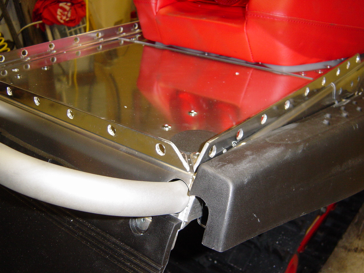

I was curious to see what everyone else has done.... Here's a pic of my 03 Viper ER that I made rail rack for...
If you've put a rack on, please show me your pics so I can get some ideas..
