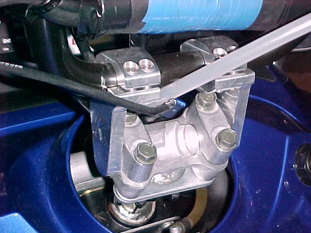

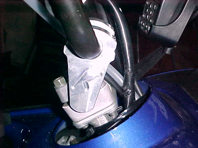

I use a Rox 2" articulating which allows the bars to be moved both forward and up. I installed 2005 RX Mountain throttle and choke cables. I works very well for all around riding, if I was strictly mountain riding I'd go taller.

I just got a 2" Rox articulating riser for my 05 Vector (with standard handle bars), and haven't tried putting them on yet.

It is pretty tight with stock cables. If you have the riser tilted forward rather than straight up you can probably get by with stock cables. If you try it make sure you check it out with the track off the ground and turn the bars all the way in each direction. 05 cables from Yamaha are fairly inexpensive..about 40 bux for the pair.

Chance, nice pics. Thats the same setup I'm using except with hand guards and no mountain strap. I used stock cables, and you're right they are tight but work with the bars way forward. Next upgrade is to an 06 seat, or BOSS.
I have the same setup on my WARRIOR(05) with stock cables and no issues at all.
