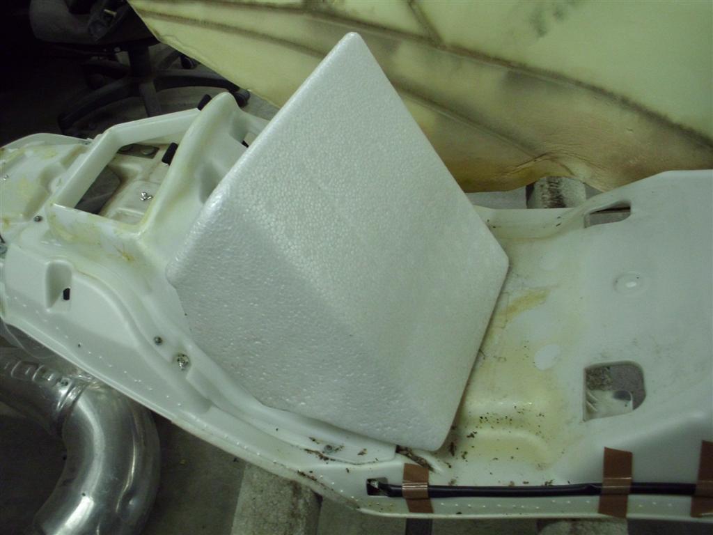

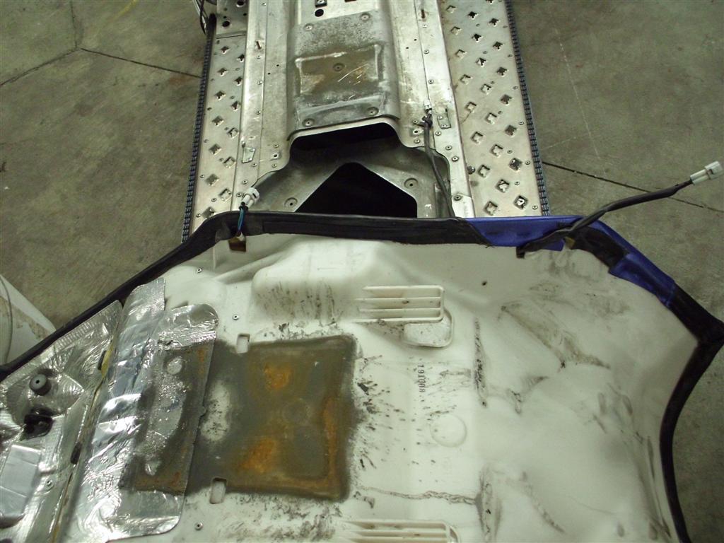

Here are are couple pics of the foam insert and the shorter cable. See the tail light cable from the mountain seat exits about halfway along the seat instead of at the rear in the tail light pod like they do on a ER Apex. If you look closely in the cable pic you will also see the styrofoam is visible under the tabs that slide beneath the fuel tank. On a ER seat under the tabs you will see the tan color of the foam as the foam fills the cavity area that the styrofoam is sitting in.
The shorter cable will actually just make it to the rear tail light but you will have to remove the tape holding the cable to the seat mould, pull the cable along towards the back of the seat a little and run the tail lights cable along the side of the seat for it to reach it.
