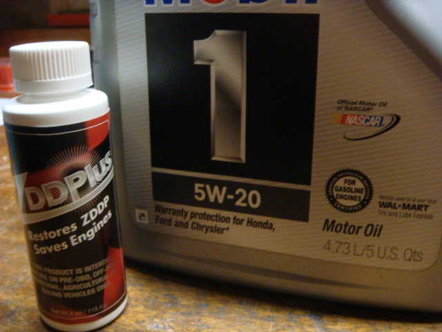

I have run Mobil 1 for the past 3 years. Seems fine, however I decided to add zddp this last oil change.

I am currently using 0-30 Mobil1 in both a 06 and 09 Vector. I do however add zddp.

The zinc and phosphurous levels have been reduced significantly in automotive oils to pass EPA. From what I have read this is not good in high performance motors. That is why people are putting in the zddp.. I know lots of guys run mobil 1 and have for several seasons in their apex and RX-1 so you will have no problem with just the mobil 1. If you want to add the zddp, I think that is a good idea but you won't hurt anything to run just the mobil1 that you have..

my question isnt really about the mobil 1, its about the energy conserving? Since the manual specifically says to not use it. Maybe I will just use amsoil ow 40.

The starter has a clutch that is located in the stator side of the engine. ATV use the same setup but I'm not sure about motorcycles. The clutch (#6) is a roller bearing assembly that engages rollers on the hub of the starter gear (#8). the clutch is directional and is a metal to metal engagement. The starter doesn't have anything special (no bendix to move a gear forward for engagement like in cars). It is a basic DC motor setup.
I'm not sure if automotive oil is the best. I think it goes back to the lack of the proper additives (zinc, phosphorus) which protect metal to metal contact points like the starter clutch and cam shaft)
Because there are to many unknowns I'm sticking with Yamalube. At $8 a quart for semi synthetic compared to mobile 1 (plus an additive) your not saving much.

it is a one way roller bearing clutch. like grizz says metal to metal. no need to worry about friction modifiers. the only thing that i see wrong with car oil is that its not formulated to run the extreme high rpms our motors turn at. it is cheaper to run car oil, but i just dont feel it holds up as well as oil designed for motorcycles ect. that and the lower zinc content. i know that amsoil does not cut back on the zinc and phos for thier motorcycle/small engine blends, as well as a few other brands.

this is excactly what i was saying.....where the starter engages underneath CASE 1 in diagram....there is very very little OIL that sits in that case. the magneto is underneath there and this is why little oil actually is in contact with the starter. So no worries about "WET CLUTCH in the starter. Pics below of when i built my motor .
the ONLY oils that have reduced levels of Zinc and phos(ZDDP) are automotive oils in the 20 and 30 weights as their second number.
if you add ZDDP additive to the mobile 1 auto oil that is fine. or use a 40 weight which just about ALL brands have higher zinc in the 40 wieght.
or use REDLINE 5w20.....it gives you the lighter viscosity for more HP and lots of zinc.
its all your own choice...still to this day no oil has causes any issues on our sleds that i have seen ever.
