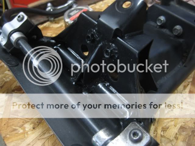

I've repaired and reinforced several bent frames. I found it easier to straighten the frame with it still mounted. The pry bar method works well if the frame is only slightly bent but I've had a few that required a little more persuasion so I built a jig and use an old arm to align things. The center gusset plate is always bent so I cut it out before attempting to do repairs. Also the subframe's a-arm bolt holes are almost always egged out which can account for a lot of the lower a-arm misalignment. I partially fill the holes with weld then die grind them out to bring them back to specs. On my own Nytro I've welded the nuts to the subframe mounts similar to how the upper a-arm are mounted.
Check out my pictures: http://s589.photobucket.com/albums/ss33 ... %20gusset/
If you have any questions on straightening and gusseting the frame send me a PM and I'd be happy to help out.

are you tig welding these reinforcements in or Mig welding. I bought the kit from you earlier this summer and am debating on whether to mig it myself or have someone tig it. I think mine is ever so slightly tweaked based on the space between the shock springs on each side. Is this a good way to tell? The plate with the hole in it has a very slight wave to it.

Mig it
Judging by the splater on his, it was done with a Mig as well. Really no reason to spend money to have it Tig welded.

use the pry bar method to center up the shocks and mig the gussets in. You can cut out the bent center plate and replace it if you have concerns but I don't think it's a must. I've been replacing it because it's always bent and with a 12 ga. chromoly replacement installed the Roest skid plate has better backing and support.

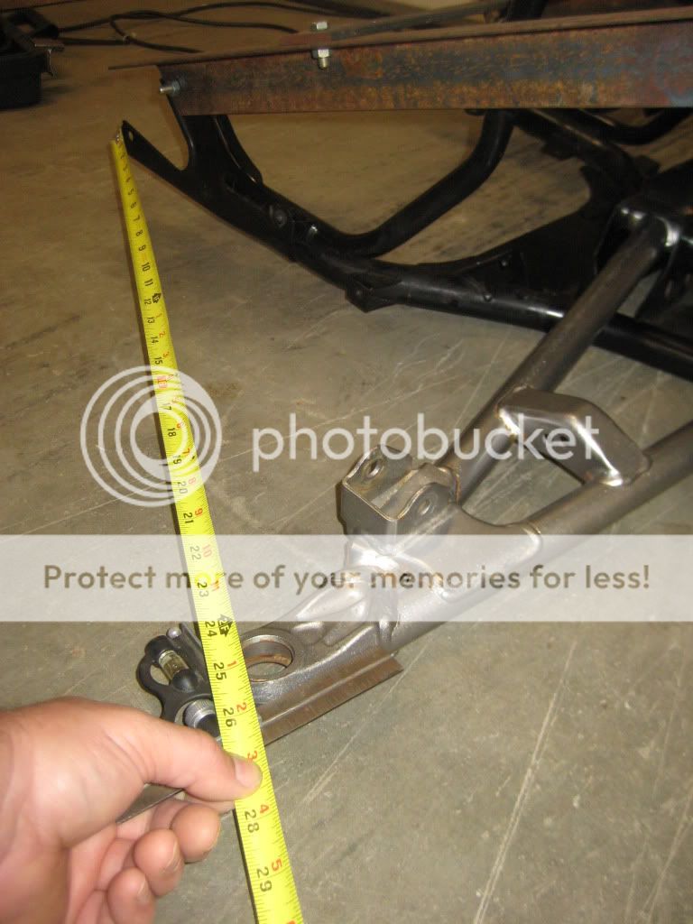

Where should i measure to find out where its bent? I got both frames laying on the garage floor right now.

As long as you have good lower a-arms and tight bushings this method works for checking frame alignment. Make sure you check the mounting holes in the frame for egging.

Did som measurements, and the frame did not seem that bad. Seems like i got it straightened out pretty good when i jigged it earlier this season.
The a-arms are much worse.. Its a good thing my skinz concept front end is right around the corner..
Thanks for the pictures. Looks very good!

i installed gussets similar to what you have done,and i think it is a good idea,but in addition,you mention the skid plate,i think that this is important also,i built one similar to roests',but used tee nuts welded to the frame to mount the skid plate,if for no other reason to see if i could hold the frame square.during the course of the season i sheared off the bolts a couple times,so in my mind there is some racking going on,that the skid plate is helping to reduce.grizztracks said:rlcofmn said:Mig it![]()
