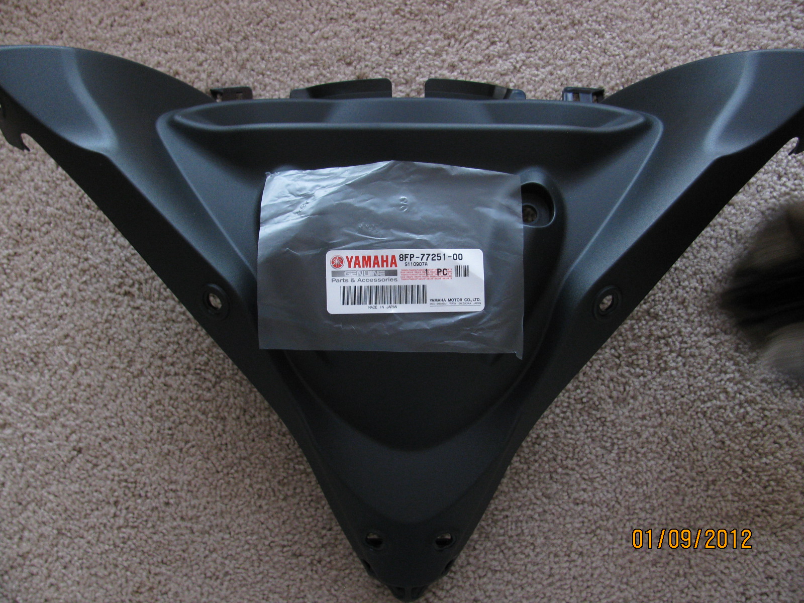

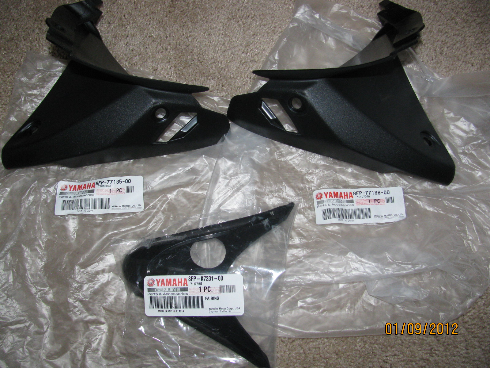

These 4 parts will let you use all your old shorty and tall windshields from the previous years on your 11'-12' Apex's.
Zoom the pics in and you can see the part numbers. I got them all for $135.00 online from partforyamaha.com
The shipping was $17.50 , but I searched google and found an online coupon code that took $6.18 off of that. So total was 134.95

I must be missing something here. Why would you pay $135 for parts that are required to be able to re-use an old windshield when you can buy a new windshield that fits properly without requiring additional parts for less money?

There is only 1 windshield available at the moment for the 11'-12' apex. That is the stock one that comes on it. Nothing else will fit.
If you want to change so you can use all the different sizes and colors available for the old apex's you must change the mounting hardware.
