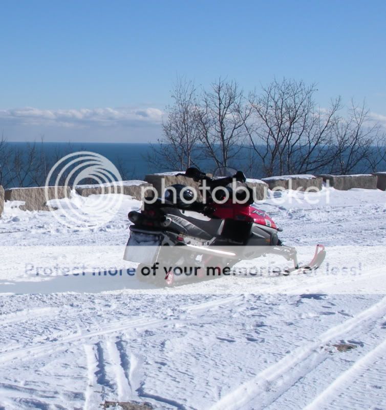

Has anyone done a seat mod from a website called sledseats? It is added on foam with a new cover, it pretty much looks like an Apex seat mod when its done from what I can tell. Just wondering if anyone has any experience with one good or bad. And if so how tuff was it to install and make look good?

Thanks sledheed, actually that is Afton, MI. Actually I am interested in a particular seat kit from sledseat.com and was wondering if anyone had experience with that. They offer a kit that has a built in "trunk" on the back of the seat that can help with the RX storage issues.

I have the kit with the map pocket.

That's the one i was looking at. How do you like it? Are you happy with the quality of the cover and foam? Did you have to cut down the fuel tank cover? Sorry for so many questions.
abj87
Yes I'm happy with it, it give you a little extra height but the best part is the added storage and map pocket.
The cover and foam are good quaility, you remove the old seat cover. Glue down the new foam and staple the cover onto the seat frame. Since it used the stock seat i did not have to trim anything.

Just did my seat today, went to Joann's fabric and got two pieces of 4" foam for $20 (50% off sale) came out looking good i think. Firmer and higher than stock, very happy with it. Just need snow now to try it out
very cool making your own seat. How many inches of foam did u stack on it? How did it hold up when riding?
carsrtoys4me
4 inches, and held up good, no problems. Much more comfortable to ride, also added 3 inch riser, those two mods made the sled fit me and my riding style better.
grossman
No issues stretching the vinyl over the additional 4 inches?
I did one RX1 the do ityourself JoAnn fabric way and one with the Apex seat swap. The Apex seat is better for us, the 4" stuffed seat still.isn't tall enough. My 5' daughter rides that now. I will have to check out the kit...sounds nice.
carsrtoys4me
No problems stretching vinyl, using a hair dryer and a couple extra hands helped
