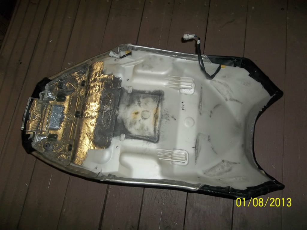

Here is the seat I bought
For this seat, the seller knew that the seat was from an Apex Mountain. However, sometimes sellers don't know what to look for to indicate what they have for sale. Sometimes, they are selling a seat they got at a swap meet and don't know what model it came from.
Contrary to popular belief, the location of the colored stripe is not a tell tale identifier for a seat from an Apex Mountain or RTX. The difference in the seat from the Mountain or RTX to an ER or GT is that center core inside the seat is mostly solid styrofoam topped with softer foam on the RTX and the Mountain models. The GT and the ER models just have a soft foam under the seat cover all the way down to the seat pan.
To be informed when shopping for a Mountain or RTX seat, view a photo of the bottom of the seat you are interested in. Look at the 2 square holes in the seat pan behind the hooks that engage the gas tank. If you see white solid styrofoam, you are looking at a seat from a Mountain or RTX. If the seat has that styrofoam and has a taillight wire that extends all the way to the taillight location you are looking at an RTX seat. If that wire harness ends near the bottom of the seat well short of the stock tail light location, it is a Mountain seat. If all you see is yellow or tan foam through the square holes in the bottom of the seat, it is from an ER or a GT.
To check, against the photos above, you can see the white solid styrofoam and the short wire harness. That confirms I bought an Apex Mountain seat.

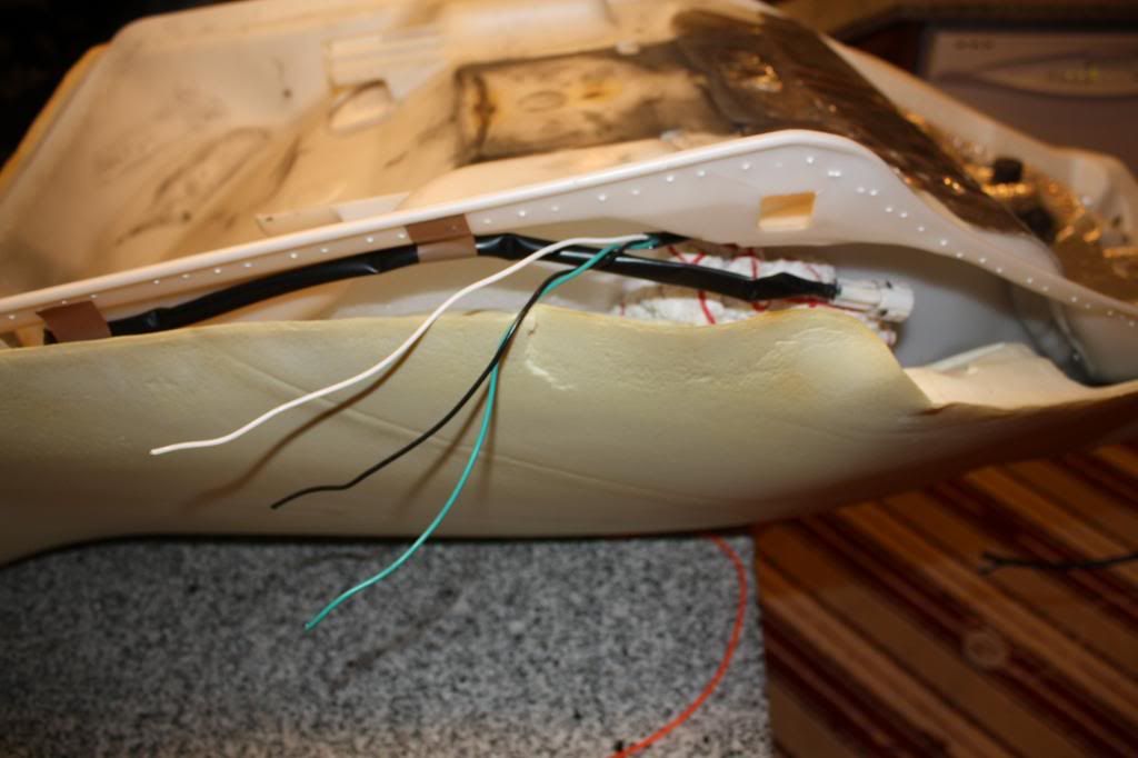

Extend Wire to tail light location
Because the tail light wire harness is different on the mountain sleds, I used some string trimmer line to fish a length of wire along the passge-way that is moulded into the seat pan for the regular trail-sled tail-light wire. I got the trimmer line fished through in one try and used it to pull the new wire through. Very easy to to. For wire, I used an old power cord from a PC. It has a heavy black jacket and has 3 wires of similar gauge to the sled's tail light cable sub-lead.
All of the connections are soldered and double heat shrink wrapped. With the wiring all done, the last thing is to do is recover the seat. This step proved to be most difficult and I ended up going to a local upholstery shop to have it perfect.

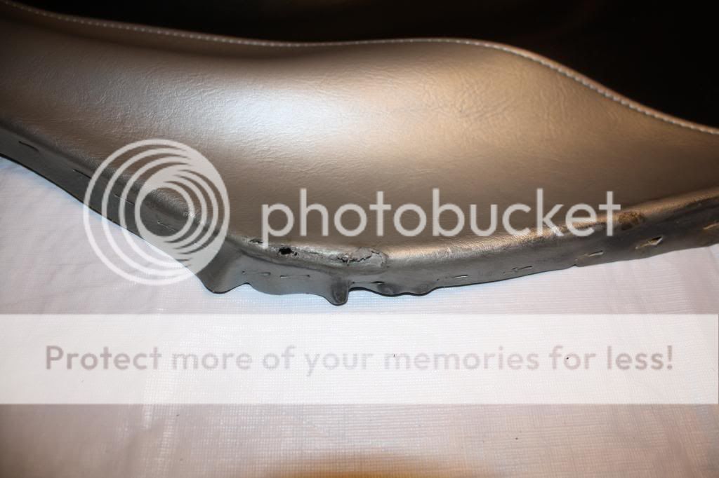

The seat pan on these sleds is a rather hard plastic and unfortunately the stainless and monel staples that I was trying shoot with my gun, continuously bent over and would not penetrate the seat pan. For every 1 staple that would sink in 15 staples would bend over FUBAR'd.
As such, it was time to make a decision, go to a shop and have it done or go and shell out more money on a new pneumatic gun from Harbor Freight (everyone's favorite Chinese Tool Store!) and maybe even more staples. I chose the shop. I dropped off the seat at 6am and it was ready at 1pm
. Stretched even, steamed to fit, and stapled wrinkle-free with stainless hardware!
