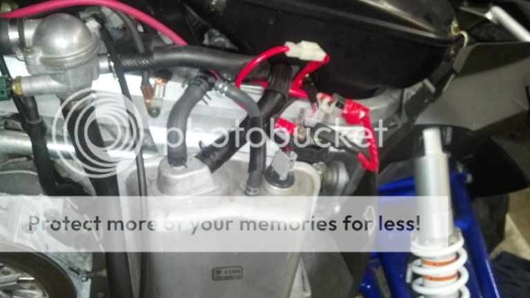

Of course we are suppose to leave on the 16th for our yearly western trip and I decide to change my oil and while I'm doing that I decided to relocate the battery since its such a dumb spot for it and the starter relay, anyway.
As a note the sled ran fine before I started all this.
I built a custom under tunnel exhaust a few years ago then I had a custom tunnel cover built and got a Mountain Mod seat the following summer.
Since I have the room under the seat I relocated the battery under the seat. (see picture)
I ran red 6 gauge wire from the battery to the starter relay and then ran a new piece of wire from the relay to the starter, since I relocated it just over the frame above the oil tank.
I then ran black 6 gauge wire from the battery to the oil tank mounting bolt where I bolted it and the OEM Negative cable to each other in the bolt hole holding the oil tank on. The negative cable is still connected to the motor at the starter, so it's actually connected to the frame and the motor. (see picture)

I guess I had the cables hooked up wrong on the starter relay, although it's the same as my 660 Raptors and they run fine. I started looking online for pictures and found a pic with the cables still attached. Go figure........two days worth of frustration.
