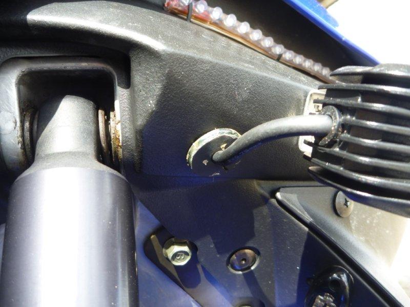

Can you post a pic showing a close up on how and where you mounted them?

RX1MPete said:Can you post a pic showing a close up on how and where you mounted them?
X2, curious on those myself.

No problem, here they are. Had to drill a couple holes for the bolt and wire harness. Used a spade wood bit for the harness, it worked great. Bought a rubber gromet and glued a rubber washer to it for the hole with the wire (probably overkill but I like a finshed look). Mounted a lighted toggle switch with double sided tape (3M) to under the headlight switch (lights up when the lights are turned on).
If you're thinking they can't make that much difference... order them (20 degree beam) and hook them up to a 12v source after dark; I doubt you'll send them back.

Thanks thksnow, appreciate the pics and info.
