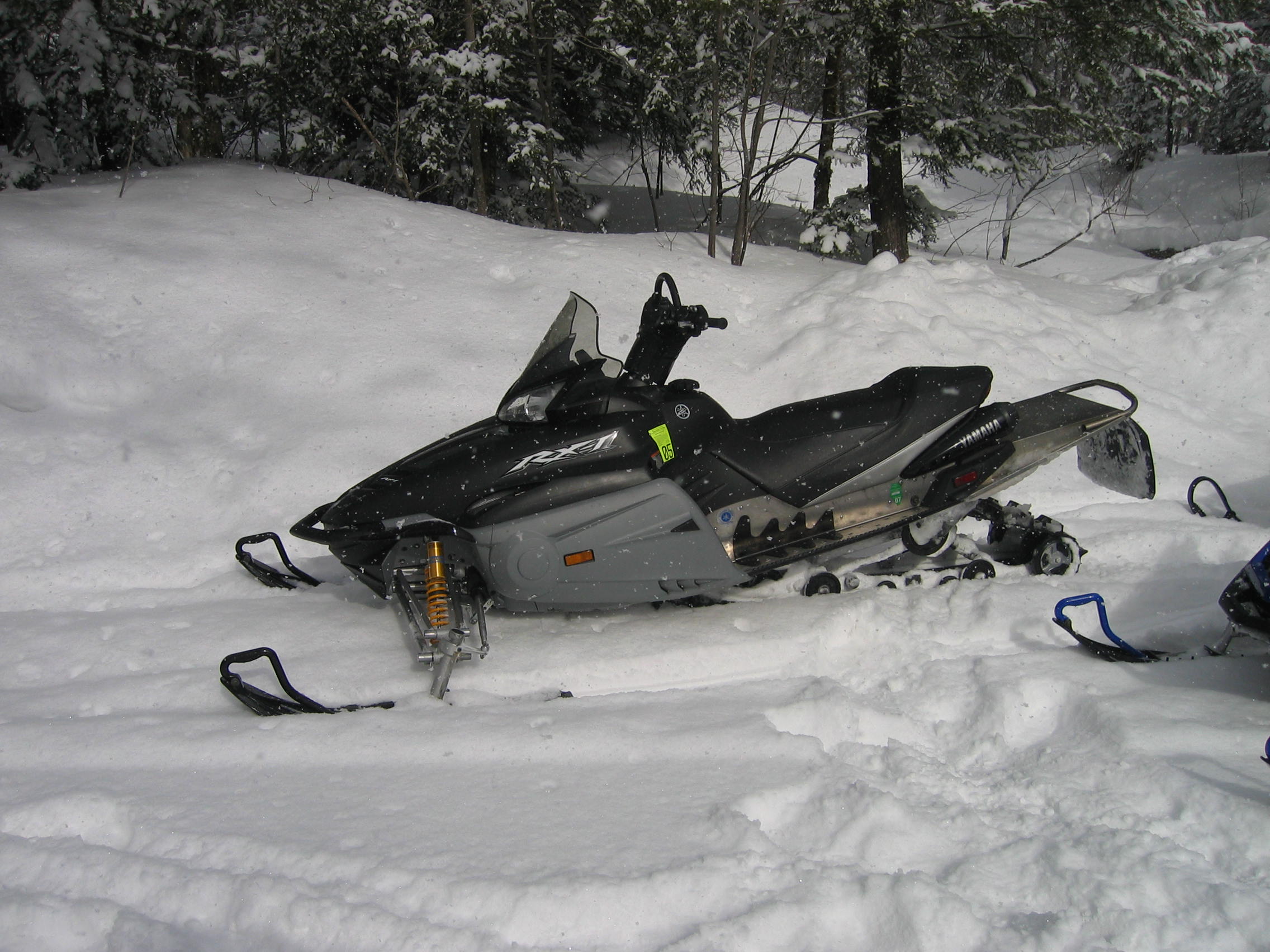

I'm wanting to clean up the factory tunnel extension('05 vec. mnt.) with a 156 or 159 kit and would like to see pics of anyone that has done this. I would like the 159" but won't be upgrading the track for some time and don't want something that looks way outa place... any thoughts? Thanks.

I would go with the 159. You really can't tell the diff, and when you want a longer track, you will not have to change the tunnel ext again. I will try to post pics of my tunnel ext later.

I would get the longer one, I ordered mine for a 162 and it is too short, perfect for a 159" though.
I talked with Hartman today and I think I'll go with a 159". He said it should look fine even with the 151" under it for a while.
My next question is, how hard is it to sell an almost new(247 miles) 151" stock track? I'm pondering just plunking the money down and getting the 159" tunnel extension and a 156" track....
If you got pics, post em please!!!

Thanks for the pics. I went ahead and ordered the 159" tunnel extension today. Not sure what I'm going to do about my track. The best solution would be if I could find someone do to an even trade with... Hartman said I could go with a 159"X15X2" fine with a stock motor. I do plan on blowing it in a season or two.
