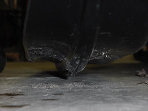

This install will lift the front edge of the carbide off the snow/ice (or turning surface) to help "cut" a turning groove for the skis to follow instead of pushing a turning groove "hunting" for a place to turn. Also this will help eliminate darting in most (not all) conditions.

Reinstall the ski and bumper and check to make sure the front edge of the carbide is up off the cement (used for viewing purposes) The front edge should be up about 1/8"-1/4" any more or less and you'll need a different spacer thickness to achieve proper balance.
Too much height up front can lead to different steering problems so experiment with different
thickness spacers and front carbide heights to achieve the ride you are seeking. Enjoy your more behaved front end.
