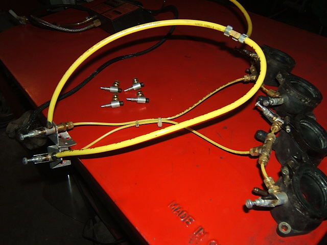

My kit showed up to day and it has six fuel adjusters,seems like alot to me all of them are set at 4 turns out and I measured the plastic nitrous nozzles at 20 hp each(also came with two 30hp brass nozzles),according to the chart I found.
My question is,can I install the four fuel jets that I have extra(which have no adjustment ,see picture)and just tune with the two main fuel jets?
I can see where it might be nice to be able to tune each cylinder seperate but it looks like the new boss kits only have 1 fuel adjuster for all four cylinders.
My therory is that with the first two adjusters set at 4 turns then the two cylinders that follow can only recieve half that amount,say two turns worth of fuel anyhow no matter where they are set.

yamahajunkie
hey steve, you got a older set-up in your boots now. the 4 extra in the pic will replace those, this is the new set-up there running. they do have 1 bigger fuel adjuster to go with the 4 inserts that you have. i havent tried to run it with the smaller adjusters. wonder why there is 2 adjusters on the main line? junkie
yamahajunkie
i would just call boss and get the 1 big adjuster, its cleaner. i had the 4 adjusters and it was kinda a pita to get it dialed in. with the one big adjuster, i know all cylinders a getting the same amount of fuel. dont get me wrong that set will work, but you could get rid of ALOT of that fuel line. see your regulating the fuel twice, and if you plan on a bigger shot later, that might be too constrictive. that bigger adjuster is a higher flow rate, and will make adjustments of fuel easy with only turning one adjuster for ALL cylinders. junkie

Thanks guys,I just finnished installing it.Im planning on adjusting it with the two main adjusters for now and calling boss to see about getting the updated single adjuster.

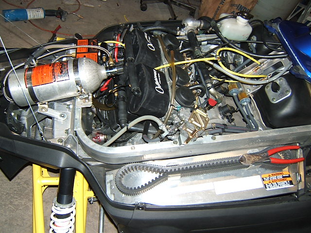

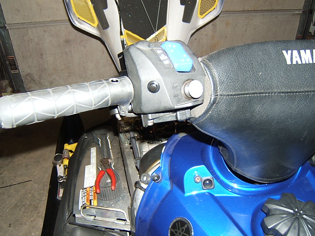

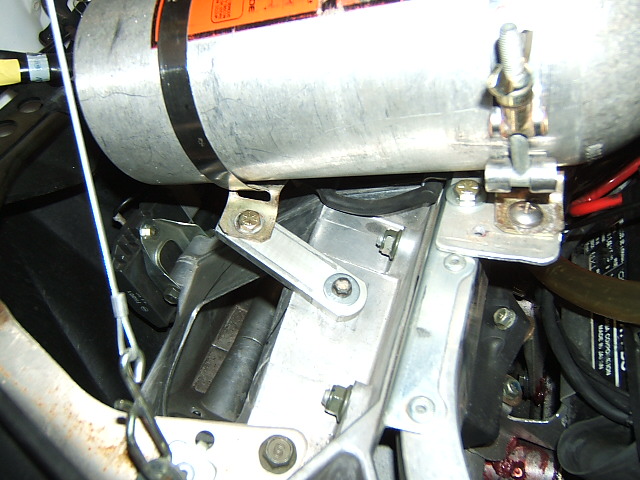

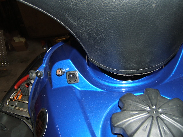

I touched it off in the yard only have 600 ft to run but it works,I can see im going to have to run the track tighter with the nitrous,now just waiting for snow.Heres some pics.
