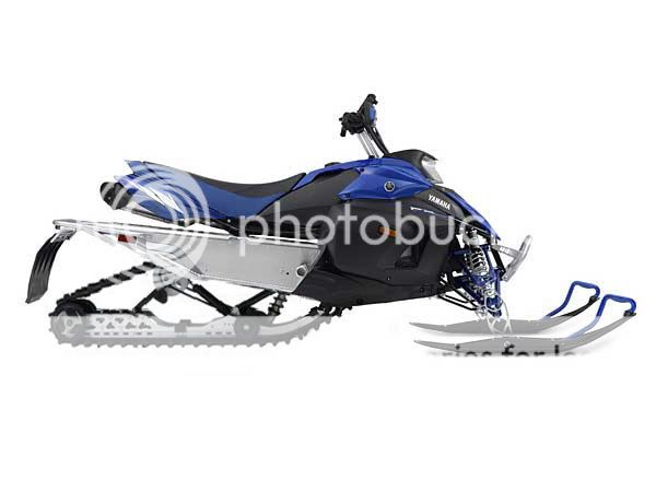

I see. I have the yamaha mountain skis, they have a deeper keel so that should compensate for the new track.
But the turbo will ofcourse try to get the skis up in the air...
Photoshopped:
Photoshopped:
