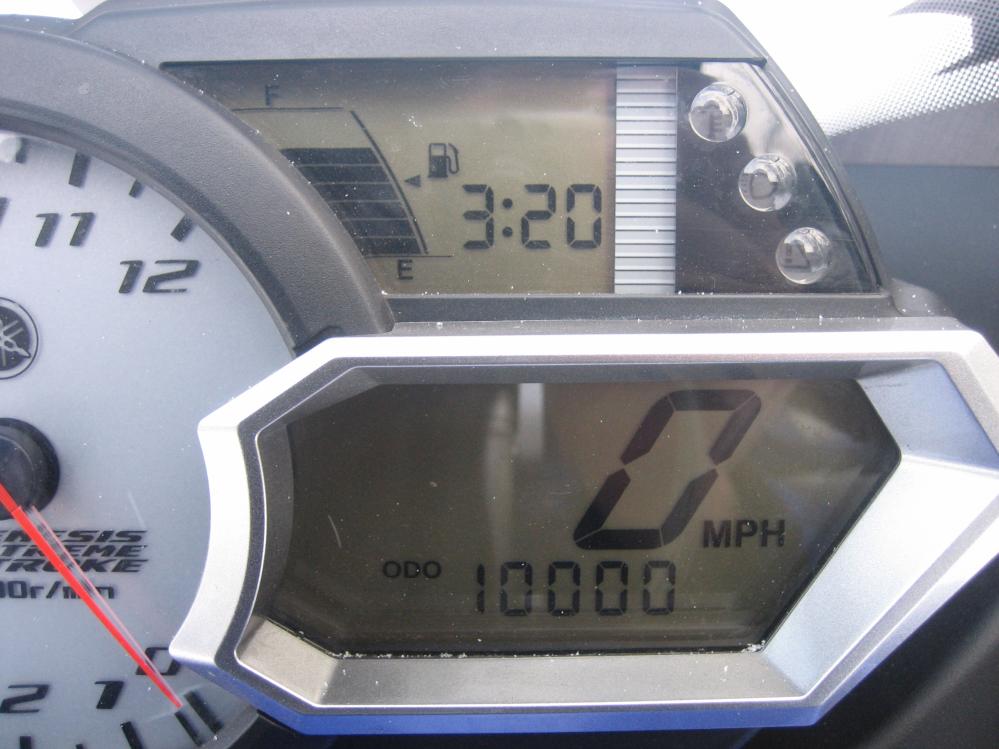

Well, I finally rolled the 10,000 miles mark on my 2006 Apex ER. This sled really is a blast to ride. Even after 10,000 miles the motor is still just as strong as the day I first rode her.

Bottom line, there are issues with this sled that need attention yesterday. But, riding long days has never been more enjoyable and more exciting.
Here is to another 10,000 miles!
